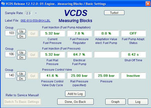

    группа 106 64.7 %
    может это для 2.0T ?
    http://wiki.ross-tech.com/wiki/index.php/2.0l_TFSI_(AXX/BGB/BPJ/BPY/BWA)#Basic_Setting
    Group 106
    [Go!]
    Field 2: Fuel Rail,Pressure (actual): 55% or below is normal at idle
    55% to 60% is a gray area, it may be okay, but may indicate a problem
    Above 60% implies there is a failure or restriction
    Causes of low pressure can include kinks or restrictions in fuel lines
    Fuel filter issues including restricted/clogged or incorrect part number
    Failing lift pump in fuel tank. We have seen numerous cases of sub-standard quality "factory" replacements in "factory boxes" that were obtained from aftermarket sources and are not sourced from official dealers. This led to troubleshooting problems that were solved by installing correct factory parts. We encourage customers to only install lift pump and fuel filter sourced directly from a VW/Audi dealer.
      164,3 КБ
      243

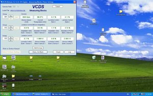

    когда проблема присутствует
      94,1 КБ
      379
