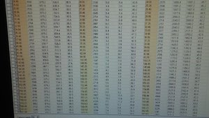

    Хотелось бы услышать комментарии знающих людей, все ли в порядке или есть на что обратить внимание :hospital:
    Sunday,12,September,2010,19:32:27
    4Z7 907 551 D,,2.7l V6/5VT G 0002,
    ,Group A:,'001,,,,Group B:,'002,,,,Group C:,'115
    ,,Engine Speed,Coolant,Lambda Control,Lambda Control,,Engine Speed,Engine Load,Injection Timing,Mass Air Flow,,Engine Speed,Engine Load,Boost Pressure,Boost Pressure
    ,TIME,(G28),Temperature (G62),Bank 1,Bank 2,TIME,(G28),,,(G70),TIME,(G28),,(specified),(actual)
    Marker,STAMP, /min,°C, %, %,STAMP, /min, %, ms, g/s,STAMP, /min, %, mbar, mbar
    ,150.85,1000,90.0,-0.8,-0.8,150.26,1400,26.3,2.38,8.78,150.55,1120,19.5,990.0,1040.0
    ,151.76,760,90.0,-2.3,0.0,151.15,920,16.5,2.04,4.50,151.46,840,17.3,990.0,1020.0
    ,152.66,720,90.0,1.6,2.3,152.06,720,19.5,2.38,4.42,152.36,720,18.8,990.0,1010.0
    ,153.57,720,90.0,-2.3,-1.6,152.96,720,19.5,2.38,4.47,153.27,720,19.5,990.0,1010.0
    ,154.47,680,90.0,-3.9,-3.1,153.87,680,19.5,2.38,4.14,154.17,680,21.8,990.0,1010.0
    ,155.38,640,90.0,-2.3,-5.5,154.77,640,22.6,2.72,5.00,155.08,640,24.8,990.0,1010.0
    ,156.28,1000,90.0,0.8,0.0,155.68,640,28.6,3.06,5.86,155.98,680,48.9,990.0,1010.0
    ,157.19,2000,90.0,6.3,6.3,156.58,1320,72.9,8.16,29.69,156.89,1840,75.2,1320.0,1030.0
    ,158.10,2520,90.0,-2.3,-3.9,157.50,2240,99.2,10.54,69.00,157.79,2400,101.5,1300.0,1260.0
    ,159.01,2480,90.0,-5.5,-7.0,158.41,2520,92.5,9.18,69.25,158.71,2440,69.9,1030.0,1260.0
    ,159.91,2840,90.0,-3.1,-3.1,159.31,2640,88.7,9.18,72.47,159.61,2800,92.5,1230.0,1340.0
    ,160.81,2080,90.0,0.0,0.0,160.21,2600,22.6,1.70,9.83,160.51,2320,12.0,990.0,1110.0
    ,161.72,2200,90.0,0.0,0.0,161.11,1960,44.4,5.10,27.36,161.42,2080,56.4,990.0,1040.0
    ,162.63,2480,90.0,0.0,0.0,162.03,2400,85.0,8.84,63.44,162.33,2440,91.0,1230.0,1220.0
    ,163.52,2520,90.0,-0.8,-1.6,162.93,2480,91.7,8.84,67.19,163.23,2520,91.7,1260.0,1340.0
    ,164.44,2520,89.0,0.0,-7.8,163.84,2480,94.7,9.18,69.14,164.14,2440,94.7,1290.0,1350.0
    ,165.33,2200,89.0,2.3,2.3,164.74,2520,52.6,4.42,31.75,165.04,2320,60.2,1100.0,1110.0
    ,166.24,1960,89.0,0.0,-2.3,165.64,2200,94.0,9.52,63.33,165.94,2040,97.7,1320.0,1310.0
    ,167.15,2080,89.0,1.6,0.0,166.54,2000,31.6,2.38,11.81,166.85,2120,53.4,990.0,1070.0
    ,168.05,2000,89.0,0.0,0.0,167.46,2200,98.5,10.20,66.83,167.76,2200,107.5,1320.0,1310.0
    ,168.96,2760,89.0,0.0,0.0,168.35,1600,119.5,12.24,55.53,168.65,1920,116.5,1640.0,1350.0
    ,169.87,3680,89.0,0.0,0.0,169.26,2960,132.3,13.26,119.31,169.57,3280,135.3,1600.0,1570.0
    ,170.77,3960,89.0,0.0,0.0,170.17,3840,141.4,13.94,156.03,170.47,3880,139.1,1630.0,1620.0
    ,171.69,4160,88.0,0.0,0.0,171.08,4000,139.1,13.60,162.81,171.38,4120,139.1,1550.0,1620.0
    ,172.61,4240,88.0,-2.3,-2.3,172.00,4200,129.3,12.92,157.92,172.30,4160,127.8,1450.0,1540.0
    ,173.53,3240,88.0,0.0,0.0,172.92,4280,72.9,6.80,89.36,173.23,3960,103.8,1270.0,1430.0
    ,174.44,3240,88.0,1.6,2.3,173.83,3160,91.0,7.82,79.75,174.13,3160,45.1,990.0,1220.0
    ,175.34,2400,89.0,0.0,0.0,174.74,3160,88.0,8.84,82.28,175.04,2640,95.5,1280.0,1390.0
    ,176.25,2440,89.0,0.0,0.0,175.63,2360,16.5,1.36,6.44,175.94,2320,9.0,990.0,1090.0
    ,177.15,2880,89.0,0.8,0.0,176.55,2680,79.7,9.18,66.08,176.85,2760,98.5,1590.0,1220.0
    ,178.06,2760,89.0,0.0,0.0,177.45,2960,129.3,13.26,119.94,177.75,3040,135.3,1620.0,1610.0
    ,178.96,2520,89.0,0.0,0.0,178.35,2520,25.6,2.04,9.25,178.65,2520,11.3,990.0,1130.0
    ,179.87,2560,89.0,0.0,-0.8,179.25,2560,36.1,4.42,30.72,179.56,2720,73.7,990.0,1030.0
    ,180.77,2320,90.0,-0.8,-0.8,180.17,2600,35.3,4.08,26.92,180.46,2480,13.5,990.0,1080.0
    ,181.68,2760,90.0,6.3,7.0,181.06,2440,9.0,1.36,6.92,181.37,2560,35.3,990.0,1020.0
    ,182.58,3040,90.0,0.0,0.8,181.98,2840,96.2,10.20,88.61,182.28,2960,118.0,1560.0,1410.0
    ,183.49,3080,90.0,0.0,0.0,182.88,3120,135.3,13.94,123.92,183.19,3120,136.1,1610.0,1590.0
    ,184.39,2840,90.0,0.0,0.0,183.79,3040,136.8,13.94,121.56,184.09,3000,138.3,1610.0,1600.0
    ,185.30,2800,90.0,-1.6,-1.6,184.69,2760,78.9,8.16,61.31,185.00,2760,89.5,1310.0,1190.0
    ,186.20,2840,90.0,-3.9,-1.6,185.60,2800,99.2,9.52,82.61,185.90,2800,103.0,1460.0,1260.0
    ,187.11,2880,90.0,3.9,3.9,186.50,2840,47.4,3.74,32.11,186.81,2840,83.5,1240.0,1150.0
    ,188.01,2880,90.0,2.3,2.3,187.41,2880,102.3,9.52,80.56,187.71,2880,53.4,1110.0,1190.0
    ,188.92,2960,90.0,0.0,0.0,188.31,2920,97.7,9.86,83.89,188.62,2920,103.0,1340.0,1380.0
    ,189.82,2960,90.0,0.0,0.8,189.22,2960,59.4,5.10,45.47,189.52,2960,85.7,1160.0,1260.0
    ,190.73,3000,90.0,0.0,0.0,190.12,3000,105.3,10.54,91.19,190.43,3000,109.8,1400.0,1390.0
    ,191.63,2880,90.0,0.0,0.0,191.03,3000,46.6,3.40,33.78,191.33,3000,14.3,990.0,1170.0
    ,192.54,2880,90.0,0.0,0.0,191.92,2920,9.0,0.00,7.14,192.23,2880,9.0,990.0,1050.0
    ,193.44,3200,90.0,0.0,2.3,192.84,3000,36.8,5.10,36.75,193.14,3160,75.9,1140.0,1030.0
    ,194.35,3000,90.0,0.0,0.0,193.74,3200,97.0,9.86,92.11,194.05,3040,85.7,990.0,1380.0
    ,195.25,3000,90.0,-4.7,-4.7,194.65,3000,51.1,5.10,43.64,194.95,3000,51.1,990.0,1130.0
    ,196.16,3000,90.0,-9.4,-7.0,195.56,3000,36.1,3.40,30.67,195.86,3000,23.3,990.0,1090.0
    ,197.05,3000,90.0,0.0,0.0,196.46,3000,35.3,3.74,31.00,196.76,2960,41.4,990.0,1050.0
    ,197.97,3000,90.0,-1.6,-1.6,197.37,3000,45.9,4.76,42.67,197.67,3000,49.6,990.0,1080.0
    ,198.87,3000,90.0,-2.3,0.0,198.27,3000,50.4,5.10,44.53,198.57,3000,39.1,990.0,1110.0
    ,199.78,3000,90.0,0.0,0.0,199.18,3000,48.9,5.44,44.36,199.48,3000,57.9,990.0,1090.0
    ,200.68,3000,90.0,3.9,4.7,200.08,3000,58.6,6.12,50.97,200.38,3000,62.4,990.0,1140.0
    ,201.59,3080,90.0,0.0,0.0,200.99,3000,33.1,3.06,25.97,201.29,3000,22.6,990.0,1100.0
    ,202.49,3200,90.0,2.3,6.3,201.89,3120,43.6,4.76,41.53,202.19,3160,63.9,990.0,1060.0
    ,203.40,3080,90.0,1.6,2.3,202.80,3200,91.7,9.18,88.17,203.10,3080,91.7,1270.0,1390.0
    ,204.30,3080,90.0,-3.1,0.8,203.70,3080,97.0,9.18,87.44,204.00,3080,91.0,1220.0,1400.0
    ,205.21,3120,90.0,-2.3,1.6,204.61,3120,85.0,8.16,76.28,204.91,3120,81.2,1110.0,1340.0
    ,206.12,3160,90.0,-2.3,1.6,205.51,3160,51.1,5.10,43.83,205.81,3120,51.1,990.0,1150.0
    ,207.02,3160,90.0,0.0,1.6,206.42,3160,84.2,9.18,84.14,206.72,3160,92.5,1280.0,1380.0
    ,207.92,3240,90.0,-3.9,0.8,207.32,3200,102.3,9.52,94.86,207.62,3200,101.5,1330.0,1390.0
    ,208.83,3280,90.0,-4.7,-4.7,208.23,3240,100.0,9.52,94.86,208.53,3240,101.5,1320.0,1390.0
    ,209.73,3280,90.0,0.0,0.0,209.13,3280,100.8,9.52,96.44,209.43,3280,66.2,990.0,1340.0
    ,210.64,3440,90.0,0.0,0.0,210.04,3280,19.5,2.38,15.17,210.34,3400,54.9,990.0,1060.0
    ,211.55,3400,90.0,2.3,1.6,210.94,3440,78.2,8.16,93.00,211.24,3440,75.9,1060.0,1310.0
    ,212.45,3320,90.0,0.0,0.0,211.85,3360,92.5,9.18,90.25,212.15,3280,34.6,990.0,1280.0
    ,213.36,3200,90.0,-0.8,-0.8,212.75,3360,48.9,5.44,49.67,213.05,3320,24.1,990.0,1150.0
    ,214.26,3080,90.0,0.0,0.0,213.66,3120,9.8,1.36,8.50,213.95,3120,9.8,990.0,1060.0
    ,215.16,2880,89.0,0.0,0.0,214.55,3000,10.5,0.00,9.64,214.85,2960,10.5,990.0,1040.0
    ,216.06,2680,89.0,0.0,0.0,215.47,2800,10.5,0.00,8.69,215.76,2720,10.5,990.0,1030.0
    ,216.98,2640,90.0,0.0,0.0,216.36,2640,10.5,0.00,8.31,216.66,2640,10.5,990.0,1030.0
    ,217.88,2600,89.0,0.0,0.0,217.27,2600,10.5,0.00,8.44,217.57,2600,10.5,990.0,1020.0
    ,218.79,2840,89.0,3.1,3.9,218.17,2560,10.5,0.00,8.36,218.47,2720,36.1,990.0,1010.0
    ,219.69,2840,89.0,0.0,0.0,219.09,2920,88.7,9.52,83.06,219.39,2920,99.2,1280.0,1370.0
    ,220.60,2720,89.0,0.0,0.0,219.99,2720,54.1,4.76,36.64,220.28,2720,25.6,990.0,1170.0
    ,221.50,2680,88.0,0.0,0.0,220.90,2880,53.4,5.78,45.92,221.20,2720,19.5,990.0,1100.0
    ,222.41,2680,88.0,-0.8,-0.8,221.80,2840,45.9,5.10,39.56,222.10,2840,50.4,990.0,1070.0
    ,223.31,2640,88.0,0.0,0.0,222.71,2560,10.5,1.36,7.61,223.01,2600,9.8,990.0,1050.0
    ,224.21,2560,88.0,0.0,0.0,223.60,2640,10.5,0.00,8.17,223.92,2600,10.5,990.0,1030.0
    ,225.11,2440,88.0,0.0,0.0,224.51,2520,10.5,0.00,7.97,224.81,2480,10.5,990.0,1030.0
    ,226.02,2400,88.0,0.0,0.0,225.42,2440,11.3,0.00,7.94,225.72,2400,11.3,990.0,1020.0
    ,226.92,2360,88.0,0.0,0.0,226.32,2360,10.5,0.00,7.81,226.62,2360,10.5,990.0,1020.0
    ,227.84,2720,88.0,0.0,0.0,227.23,2480,26.3,3.74,24.03,227.54,2600,67.7,1010.0,1010.0
    ,228.74,2520,88.0,-1.6,-1.6,228.14,2720,95.5,9.86,81.06,228.44,2600,91.7,1090.0,1390.0
    ,229.65,2560,87.0,3.1,3.9,229.04,2520,64.7,7.82,53.75,229.35,2520,86.5,1210.0,1230.0
    ,230.55,2600,87.0,-5.5,-5.5,229.95,2560,113.5,11.22,87.33,230.25,2600,104.5,1350.0,1380.0
    ,231.46,2640,87.0,0.0,0.0,230.84,2640,107.5,10.20,83.08,231.16,2640,60.9,990.0,1290.0
    ,232.35,2440,87.0,0.0,0.0,231.75,2720,44.4,5.10,37.92,232.05,2640,13.5,990.0,1100.0
    ,233.26,2280,87.0,0.0,0.0,232.65,2440,10.5,0.00,7.28,232.96,2360,10.5,990.0,1040.0
    ,234.16,2160,87.0,0.0,0.0,233.56,2240,11.3,0.00,7.22,233.86,2200,10.5,990.0,1030.0
    ,235.07,2160,87.0,0.0,0.0,234.46,2120,11.3,0.00,7.08,234.77,2040,10.5,990.0,1020.0
    ,235.97,2160,87.0,0.0,0.0,235.38,2320,60.9,7.82,48.78,235.68,2320,57.1,990.0,1080.0
    ,236.88,2080,87.0,0.0,0.0,236.27,2040,11.3,1.36,5.83,236.58,1880,10.5,990.0,1040.0
    ,237.79,2400,87.0,0.0,0.0,237.19,2280,59.4,7.48,47.17,237.49,2400,80.5,1100.0,1060.0
    ,238.70,2160,87.0,-3.1,-3.1,238.09,2400,87.2,8.84,64.11,238.40,2320,94.7,1270.0,1310.0
    ,239.59,2200,87.0,0.0,0.0,239.00,2160,110.5,10.88,70.08,239.29,2160,111.3,1420.0,1370.0
    ,240.50,2200,87.0,0.0,0.0,239.90,2200,121.1,12.24,78.42,240.20,2200,58.6,990.0,1290.0
    ,241.40,2200,87.0,0.0,0.0,240.80,2200,51.1,5.44,32.44,241.11,2200,58.6,990.0,1060.0
    ,242.32,2120,87.0,0.0,0.0,241.72,2200,30.8,2.04,14.17,242.01,2160,13.5,990.0,1080.0
    ,243.22,2480,87.0,0.0,0.8,242.62,2280,51.1,6.80,41.67,242.91,2480,81.2,1130.0,1070.0
    ,244.12,2160,87.0,0.0,0.0,243.53,2280,55.6,3.40,23.33,243.82,2200,21.8,990.0,1160.0
    ,245.03,2360,87.0,0.0,0.0,244.42,2160,9.0,1.36,5.47,244.73,2200,33.8,990.0,1030.0
    ,245.93,2400,87.0,1.6,1.6,245.34,2480,83.5,9.18,64.78,245.64,2360,64.7,1120.0,1150.0
    ,246.83,2280,87.0,0.0,0.0,246.23,2280,117.3,12.24,84.31,246.53,2240,127.8,1590.0,1450.0
    ,247.74,2320,87.0,0.0,0.0,247.14,2280,138.3,14.28,92.50,247.44,2280,137.6,1570.0,1530.0
    ,248.65,2400,87.0,0.0,0.0,248.04,2360,138.3,13.94,95.56,248.34,2400,138.3,1560.0,1530.0
    ,249.55,2480,87.0,0.0,0.0,248.95,2440,138.3,13.94,98.17,249.26,2480,139.1,1560.0,1530.0
    ,250.45,2560,87.0,0.0,0.0,249.85,2520,139.1,13.94,101.47,250.16,2520,138.3,1550.0,1530.0
    ,251.37,2640,87.0,0.0,0.0,250.76,2560,139.8,13.94,105.94,251.07,2600,139.1,1560.0,1540.0
    ,252.28,2720,87.0,0.0,0.0,251.67,2640,137.6,13.60,106.06,251.97,2680,138.3,1550.0,1540.0
    ,253.18,2760,87.0,0.0,0.0,252.58,2720,135.3,13.60,107.19,252.88,2760,136.1,1540.0,1540.0
    ,254.08,2840,87.0,0.0,0.0,253.48,2800,133.1,13.60,107.58,253.77,2800,128.6,1480.0,1520.0
    ,254.99,2880,87.0,0.0,0.0,254.39,2840,125.6,12.58,105.14,254.69,2880,125.6,1480.0,1500.0
    ,255.90,2960,87.0,0.0,0.0,255.29,2920,124.8,12.58,105.78,255.59,2920,124.1,1480.0,1490.0

  17. dober1979
    dober1979 Участник форума
    22 янв 2013
    183
    A6/C5 афб 2,5 TDI
    Dobrij vecer!A moe rassifruete?Plz!
      105,5 КБ
      80
  18. velochi
