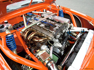

    TTX:
    Volvo B230 with navy crankshaft
    SPM H-profile connecting rods
    Venolia pistons
    16 Valve Volvo head with standard valves, port grinded with own ideas
    Self made mechanical valve adjustment
    Camshafts grinded by SPM
    Double valve springs
    Garret GT-40 turbo
    Eaton M62 compressor with an own system for control of air between the turbo and the compressor
    Exhaust manifold manufactured in stainless steel
    Wastegate with 50mm valve
    Self made intake manifold with separate 46mm throttle and full radius funnels
    Autronic engine management system and CDI ignition
    Mercury F1 ignition coils
    Self made Intercooler and watercooler
    Power:
    Max. 578Hp at 6300rpm, over 500Hp from 5200 to 7700rpm
    Torque:
    Max. 706Nm at 4900rpm, over 600Nm from 4300 to 6600rpm
    Transmission:
    Getrag 262 from BMW
    Tilton twin disc 185mm clutch with AP lamellas
    Rear end:
    Volvo 1031 axle with lamellar differential
    Adjustable fourlink
    Front end:
    Self made spring units with adjustable height
    Volvo steering aid with electrical servo
    Brakes:
    Corvette ZR1 discs and callipers
    Self made pedal group with wilwood brake adjustment and maincylinders

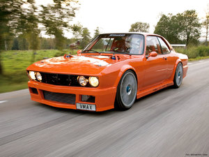

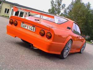

    Body:
    Own design, no plastic
    Paint:
    Opel 529 orange, own paint job

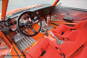

    Interior:
    Momo seats and steering wheel, lots of aluminium
    Wheels:
    BBS magnesium rims, 9,25x19” with BFGoodrich g-Force Profiler 235/35-19 in the front and back
    Weight:
    1050kg
    Performance:
    Best ET: 10,520s
    Best topspeed: 218,54km/h
    60-feet: 1,64s:umnik:

    со значком опеля?
